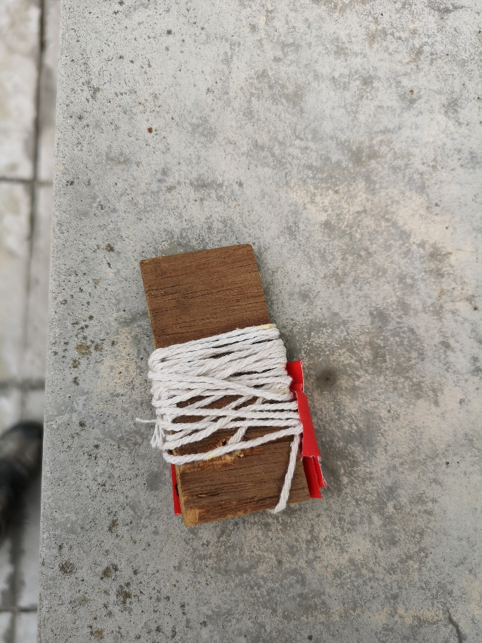

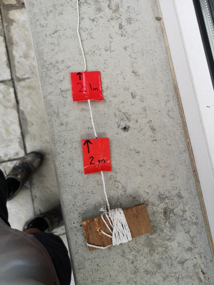

I have a bit of string tied to a small piece of wood. I hold the tape to the barrier, if the wood swings without touching the ground, I'm good to go

The calibrated string seems like a good idea.

This calibrated string idea, you know things have progressed from this don't you. :)
Ah, but that's just what they'll be expecting. Why spoil the fun, when we can waste an afternoon dreaming up complicated arrangements involving green line lasers!?
