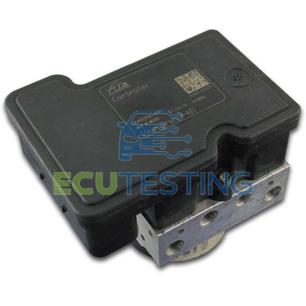

Diagnosed as faulty abs unit. Does anyone know where the unit is located and how to access?

Just for the benefit of anyone with similar issues in future. Mine is 2006 at 130k miles.
Mechanic was excited when he read this code - fault 00493 esp unit defective g419 - it was the first he had seen! Ended up fitting a new Esp Duosensor, 7H0-907-655-A, supplied by VW and fitted by independent. Total cost including labour/VAT £963. It would have been far more at VW and far less with second-hand or refurbished unit but I chose not to go that route.

Sorry I dont know what may have been necessary in terms of mechanic perhaps resetting or clearing fault codes. If I was in the same position again I would simply buy a refurbished unit for about a tenth of the price, plug it in and see what happens. Others on here will probably be able to tell you more about the fault codes. Please be sure that a replacement Esp Duosensor is what you really need, they rarely fail and other wiring or sensor issues are much more common.
