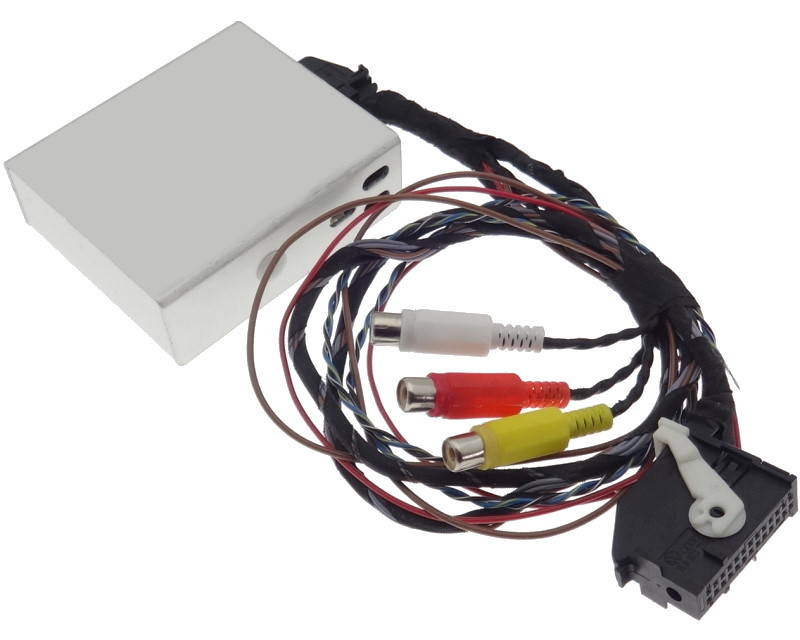

The only problem with mirrorlink is that the ruddy RNS510 doesn't have a standard RCA video in and so must use one of these type adapters;
http://www.ebay.co.uk/itm/371312461095?_trksid=p2055119.m1438.l2649&ssPageName=STRK:MEBIDX:IT

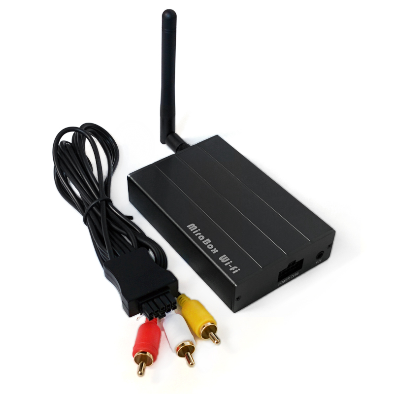

...so that I can then hook up the mirrorlink device such as this;
http://www.ebay.co.uk/itm/141264524563?_trksid=p2055119.m1438.l2649&ssPageName=STRK:MEBIDX:IT
I need to fathom out how to power these little gizmos and I will order one (I don't fancy splicing canbus connected cables!)
My feeling is that this will be cheaper at around £175 but then for not much more I could just opt for the CarPad. I guess I would be keeping the original head unit (factory look) but the downside is that the mirrorlink is display only and the phone needs to be used/controlled (although not connected).
