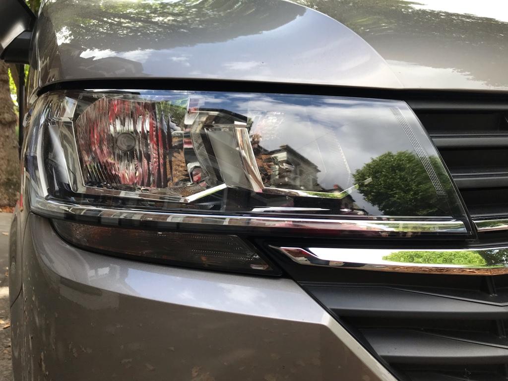

Thank you! These are our headlights - looks like separate dip and main beams, right?

Easy way to tell is to switch on headlights in Dip mode, look at headlight then switch on Mainbeam. If only one headlight light on, same one as dip, then H4 Headlights. If 2 lights now on (on each side) then H7 bubs in each light, 4 bulbs in total.

We also have a Coast T6.1 2021. I was reading on the forum about upgrading the bulbs to the Osram Night breaker and everywhere i could find suggested that both main and low beam were H7.
Having bought 4 x H7 bulbs, i now find they are H7 for dip and H15 for main beam - so now to sort some H15s.
Lesson - dont believe everything written on the forum - check then buy !

H15 combines the DRL.
I, obviously mistakenly, thought that they were only found on T5.1 headlights.
Obvious when looked at
