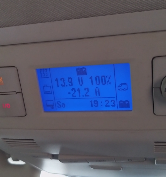

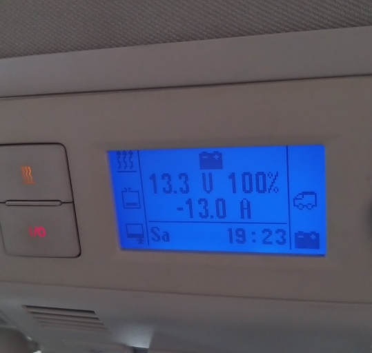

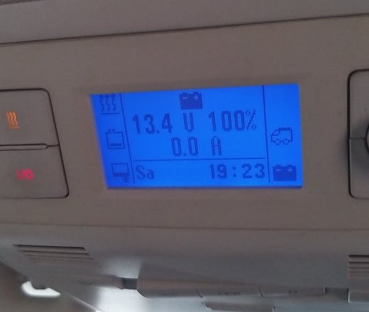

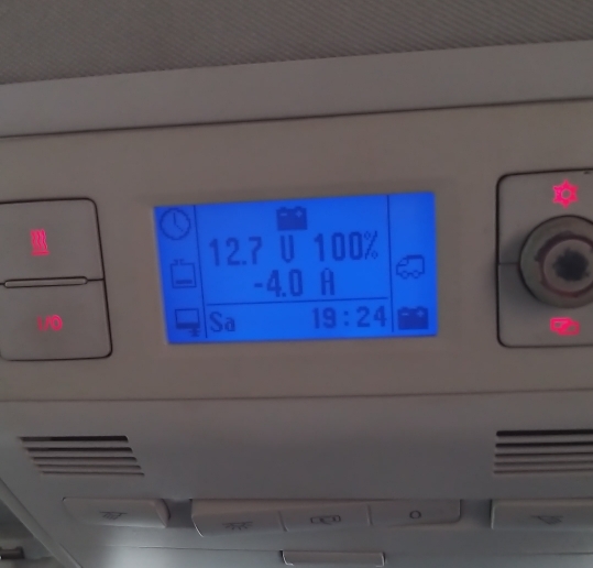

Thank you for your comments, I took a video to show the situation but I cannot upload it so I add a set of photos in time order. It clearly shows that after a very short time not even a minute it all turns off but the air vent becomes activated although only cold air. I confirm at the start the screen flickers... I wait your kind expert comments?

Either your batteries are coming to the end or its the
Earth shunt.
Lights flickering tend to point towards the Earth shunt.
