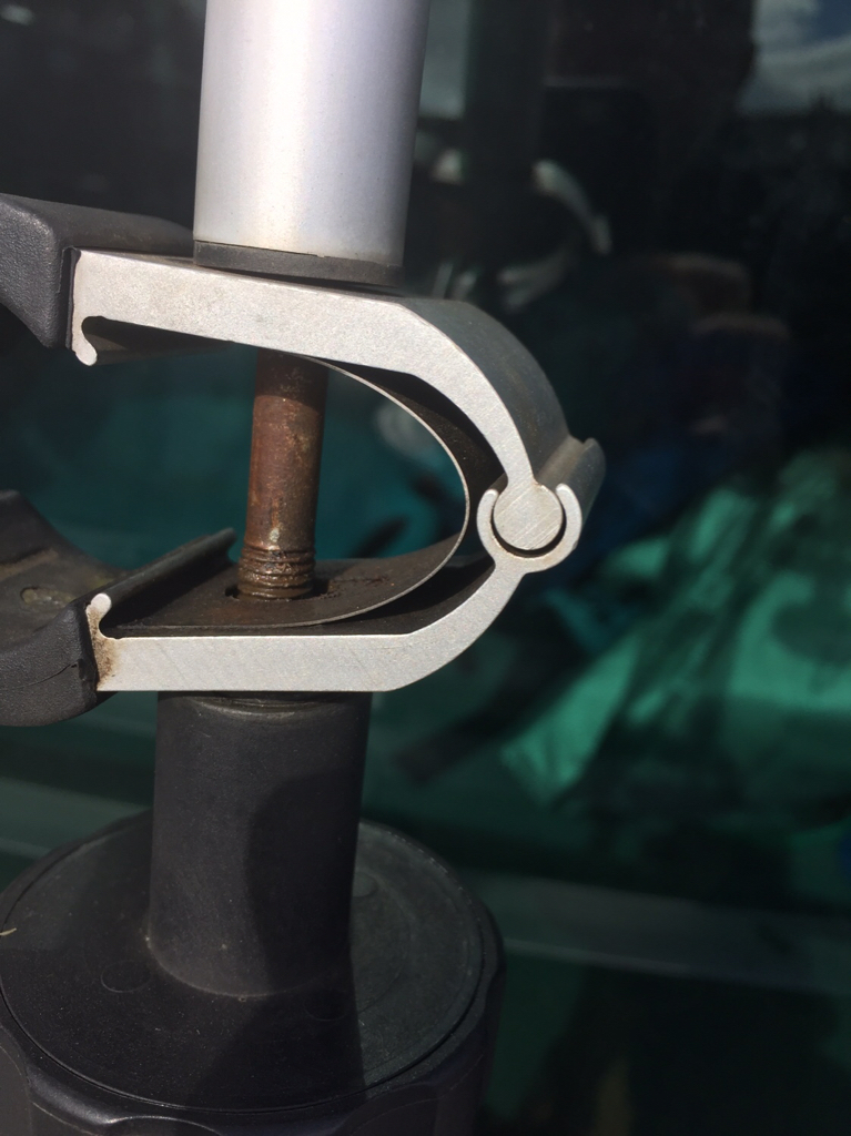

I've just had to replace the longest arm, with clamp at the end, because the thread had seized with rust and I broke it trying to free it up. Cost from the dealers- £63!!!!! Got the rack new with the van in September 2010.
I've since applied copper grease to all three arms following advice from the here - for which many thanks.
Ian E thats worrying. Any chance you could post a photograph of where you greased. There is a high chance I wouldn't notice this as I will in the main only use one arm.
Many thanks
Hi Mike - hope this works! It's basically the thread on each of the arms. Indeed the arm I had to replace was the one I use the least.
Thinking about it, I'll do a separate post to highlight the issue for others as I expect it will be a common issue.
Cheers
Ian
Yes common problem if not used very often. Had to get the threads recut on mine . Now use copper grease and check at least yearly.
Ian, Brilliant. Thanks. Just copper greased and oiled all of those parts.... Signs of rust in just weeks. I will now try to remember and do this every year.
