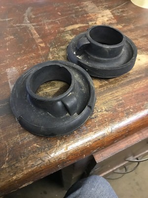

The rubber mountings will need replacing > Ebay example

There are Spring Assisters.
Raising the back for a reason is fine, but, the front should also be raised otherwise the vehicle would be nose-down which was not how it was designed regarding suspension/steering and braking performance.
Aarghh!! NOT SPRING ASSISTERS!!! (If you mean the rubber coil type!) I fitted these successfully to various Peugeot & VW estates. However, tried them on my T5 elderly SE (dsg/178bhp) along with Bilstein B6s because part of the towing assembly was bottoming over roadhumps. Result ... broken both rear springs & distorted “spring hangers”/mounts. Made the rear very stiff & taut but reckon given the weight of a laden Cali, the reduction in spring deflection put far too much stress on the spring assemblies.
Local Main dealer in Exeter refused putting on T32 springs but replacement standard springs & mounts plus the existing B6 shocks have proved fine.
