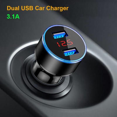

verified it with a Voltmeter connected to the engine battery before mains power switched on and after mains power on. Engine battery went to 12.7Volts after charge. usually under 12Volts when engine/alternator charged.
A simple USB cigarette plug with voltage display can also confirm charge level if plugged into dash socket.
Example model
