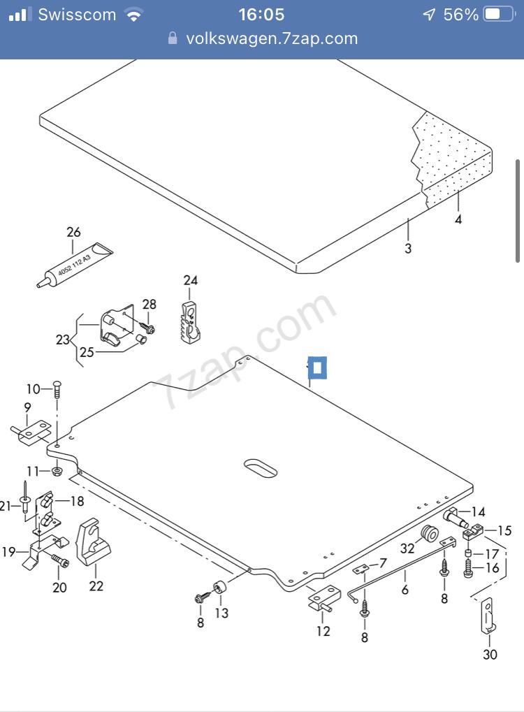

Anyone know where I can buy end rubber caps for board?
As per photo
I ended up putting some strips of self adhesive rubber insulating tape into the
keepers when mine evaporated.
The thought of going to the service dept and asking for them rubber stoppers put
me off.
I would also be grateful if anyone has a link or a part number. The part that sapto
mentioned probably comes with it.
Thank youI found it here: 7H7067177A
on the German Caliboard.Volkswagen Teilkatalog - ETKA Online Germany , Volkswagen EUROPA, original Teilkatalog Volkswagen EUROPA
Teilkatalog Volkswagen - ETKA Germany Ersatzteile Suche nach Originalnummer Volkswagen, Markt EUROPAvolkswagen.7zap.com
Did you consider a short length of 8mm gas pipe?Anyone know where I can buy end rubber caps for board?
