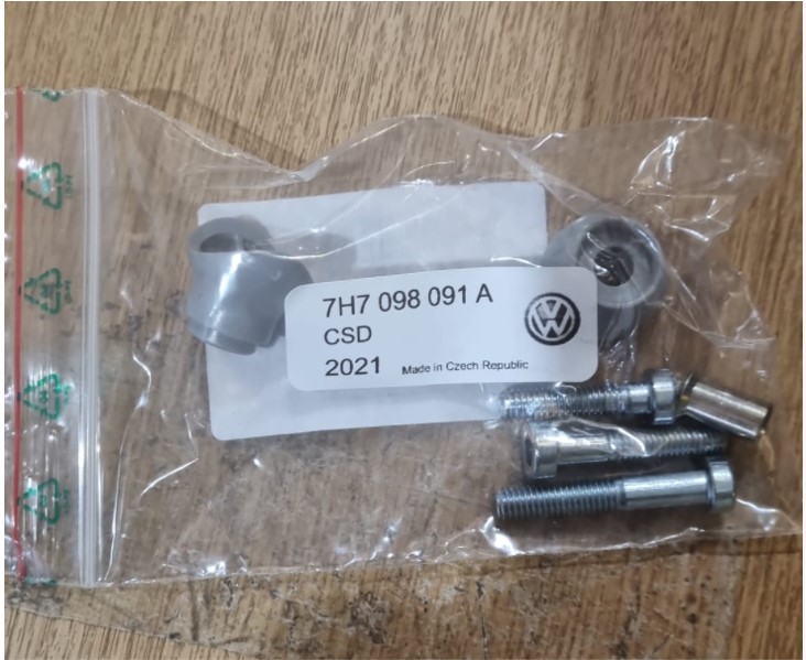

I've used the German guys parts. They cost just under €50 inc postage but you get enough parts to repair 4 of the joints. Beautifully machined bits of metal. Decent instructions too.
Just need a bit of courage when it asks you to drill out the rivets. It worked for me fine. Done in about 20 mins.

I recently ordered the parts from Domi in Germany. They arrived very quickly. You get four of the parts so have used two to fix the front of one chair. Instructions are German but easily translatable. I am no DIY person but found the repair easy, I was able to easily drill out the rivets. My plan now is to keep the repaired chairs in the loft so they are complete for future van sale. In the meantime we are using two chairs from Argus that were £12 each.
