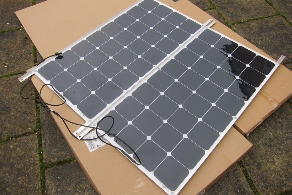

Hi all, an update to our panels this year. You may know we make bolt on 100w (and 200w) solar panel kits for the Cali (in all variations) and the T5/6 with VW roof slots, all which require no drilling of holes.
The latest batch of panels are sourced from a new UK supplier offering a robust warranty to us, which means I can continue to offer a no quibble warranty.

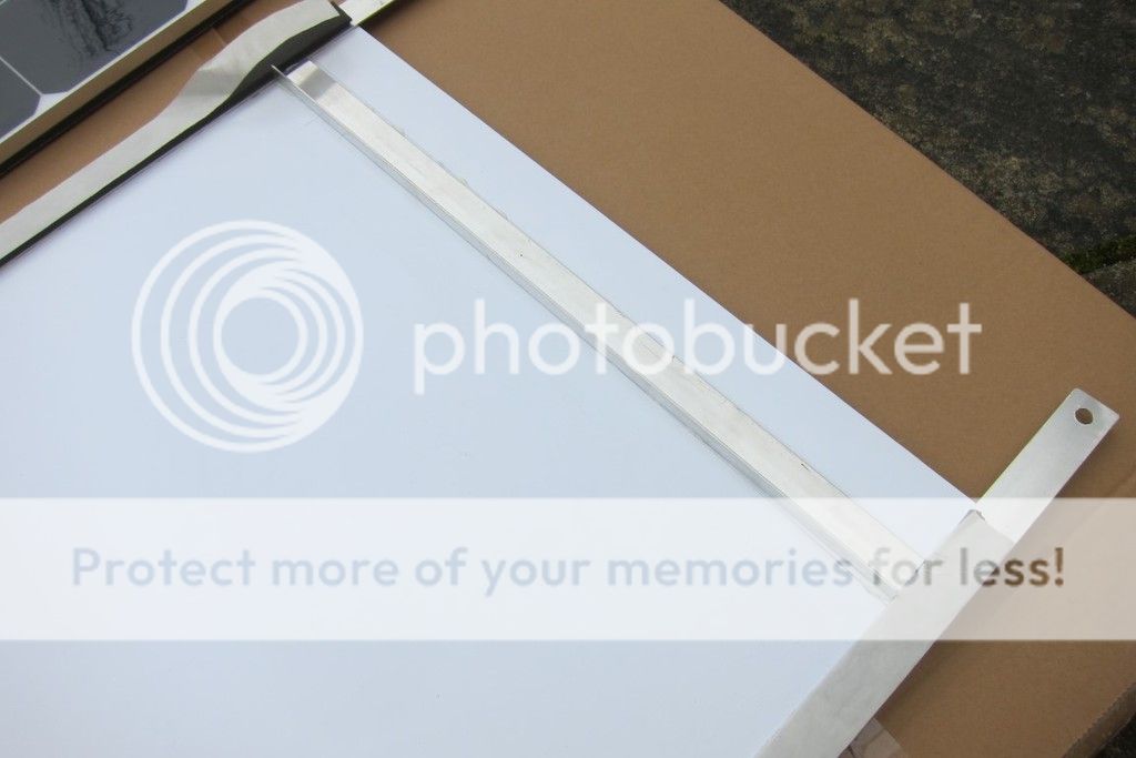

To stop vibrations/resonance, we now install lateral strengthing braces on the plastic panels. See below. This is not normally an issue but we have had feedback from faster drivers (Autobahn!) so have addressed the issue for all.

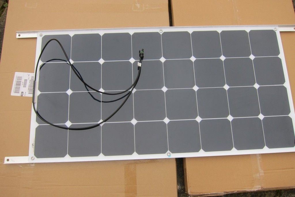

For the T5/T6 kit (non-cali) we continue to use the silver aluminium thin panels as they span a greater distance and their rigidity suits the application better.
We are also frequrently now selling 200w kits. Essentially two 100w kits with a bigger MPPT charger. The panels plug into each other, so are expandable.

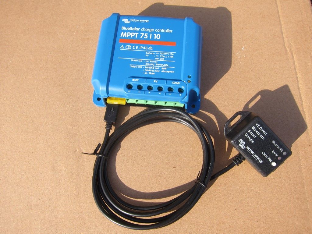

I decided to roll my own so to speak because the one drawback I saw with the displays is that you need to hack about at the van to get them readily accessible. There is another solution, i.e. the Victron MPTT controllers (there are a few threads on here with info on them) they have a Bluetooth interface, so you can use your phone or tablet as the display. With the bolt on kit this would mean you aren't doing any permanent damage to the van (except for stowing the controller in a cupboard or in the case of the Beach by the tool kit.)
I think it would also be cost effective as you don't need the display which with your current spec is an extra. My Victron cost about £80 on fleabay including postage, so you should be able to source these at volumes a lot cheaper.
Just a thought - maybe you could offer these as an option?
PS Agree wholeheartedly with the bracing - I had to make several changes to my setup to kill the vibration which seemed to come in at about 60mph. All sorted now though with some judicious usage of draft strip and pipe lagging :)

The chargers I sell all have built in LCD displays so you don't need the MT50 display - so no drilling at all - but clearly you need to open the cupboard if you like to check up on your solar performance. I'll look at sourcing some of the Victron Bluetooth chargers. I already buy their dual battery chargers for specific customers - they are very good quality, and they should be for the price.

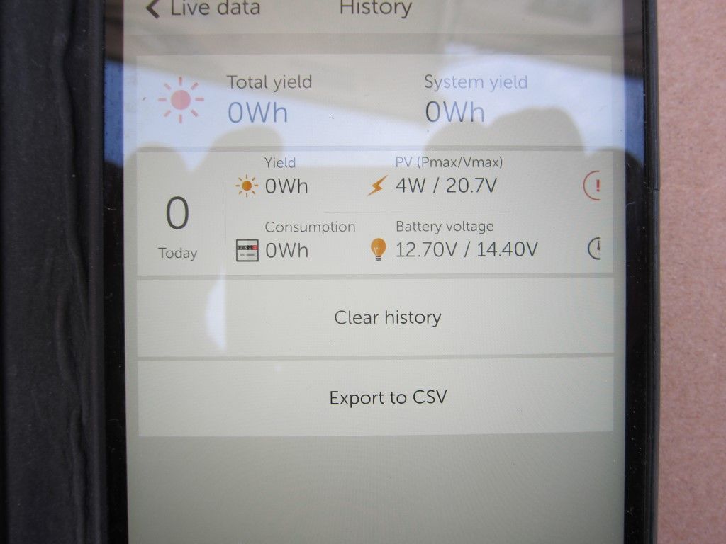

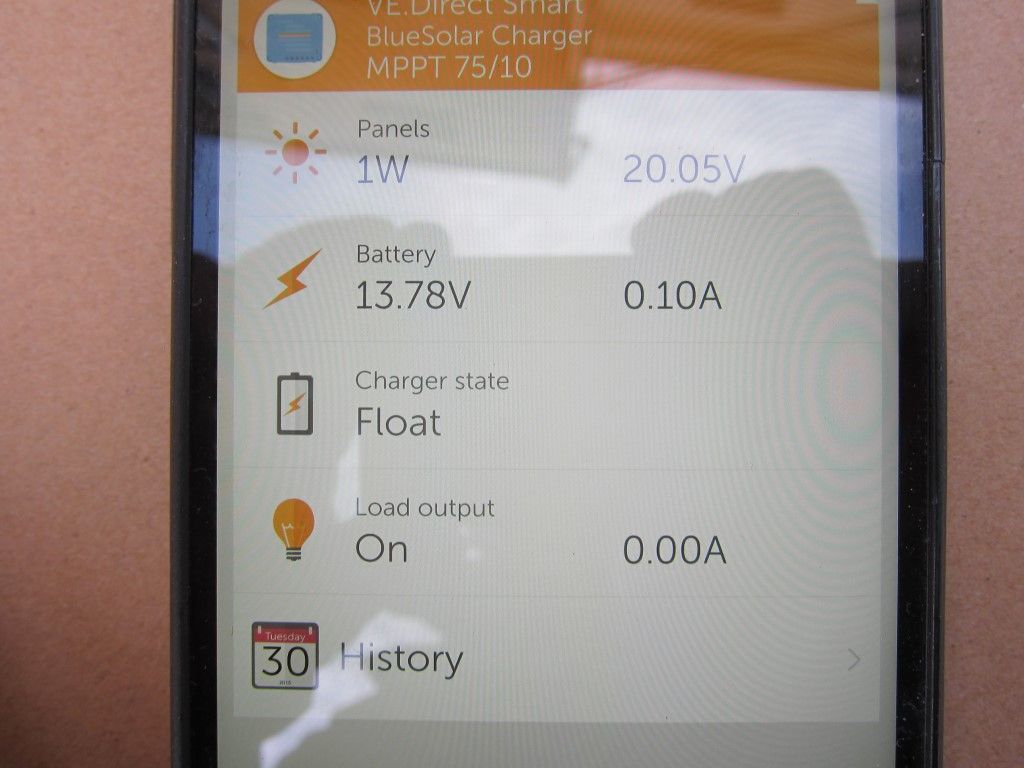

I've got a supply of Victron chargers now, with the optional Bluetooth modules. They are very impressive, particularly if you like to customise your battery charging profile, or look at historical logs.
If you want to order a kit with one let me know and I will raise a specific order as I have not updated my website yet.
One feature that particularly stands out is the ability to enable an equalisation charge schedule (where the charger limits the current for a set period of time to allow all the cells in your battery/ies to even out. This is the same as the "conditioning" that VW refers to when recommending your charger your battery from the mains once a month. On the software you can enable a monthly auto equalisation charge.
A nice MPPT charger , with no screen to install, as it's all on your phone.
I knew you'd like them once you got to play with one Roger. Hope the new season will bring lots of orders!
EDIT Roger, one thing I had to do was to make sure the bluetooth connector didn't rattle free. I just put a piece of tape round the whole thing to make sure it didn't drop out. You might want to do that so that folks won't think the system has packed in when only the connector has dropped out due to vibration. Depends a lot on how you mount the controller of course.
Thanks Simon - a good point - I noticed the connector doesn't "click" home when you plug it in.
Hope it saves you from any warranty issues :thumb
The Victron chargers are now a selectable option on our website. I am only supplying the 15Amp version as it's only £10 more than the 10Amp version, but means you can keep it if you buy a 100w panel, and then decide to add another panel in the future.
