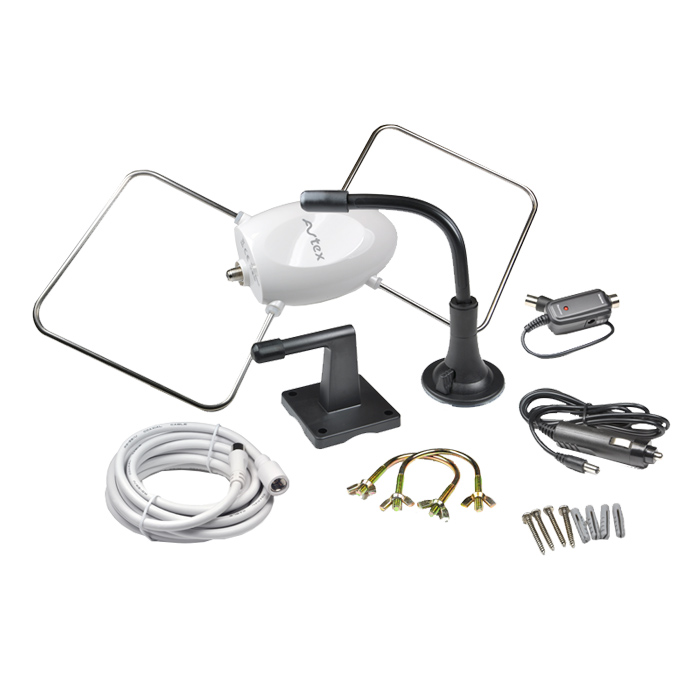

We use a small August portable TV. Some sites have a TV aerial socket on the bollard, so we just use a length of co-ax cable to connect to it. On sites with no TV provision, we use an Avtex aerial that sticks to the outside window of the van, then feed the cable through the passenger door. The aerial is powered off the 12v socket behind the passenger seat.
This is the aerial we use:
Costs about £40. Works well in most areas, we can get up to 120 digital tv channels. Even worked in the Welsh mountains and the Outer Hebrides.
