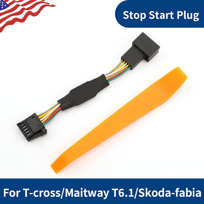

I was aware that some people had purchased & spliced a small circuit board into the factory wiring loom, I wasn’t keen on chopping into the factory loom So decided against.
recently I saw some cables coming up as a suggestion, which appear to do the job Without the need to slice a PCB into the loom. I.e a complete assembly with OEM connections.
I purchased a small pre cable assembly with an integrated circuit board, it remembers the last setting of the Start / Stop Button function.
Can be turned off to switch back to normal function if required by simply pressing the start / stop button To turn it back on (factory default)
very easy to fit, requires the centre decor trim, around the head unit, to be removed (T6 comfort Dash)
Trim tool placed In bottom left corner , next to glove box then work anti clockwise back to the top left corner.
pull the whole assembly forward and lift clear
use a trim tool to depress the metal tab on the top rear of Start / Stop button to release it from the dash.
Pull the cable forward so you can see the white plug in the back of the switch.
Unclip the white plug (depress the retaining clip with a small flat blade to release)
Plug the new cable in (Red connector to switch, black connector to loom).
re- assemble in reverse order.
Turn on ignition, press the Start stop button so it illuminates (turns off the function) . Turn ignition off.
Turn ignition back on , wait a few seconds and hey presto the Start stop button illuminates.
the last photo shows the listing for the cable (Ali Express, although they are readily available from all the usual outlets, Mega sellers, Auction sites etc. )

Yes it will work on the T6.1,
but will require a different cable, the connectors are different (the listing usually state t6 / T6.1 )
removal of the start stop button on a T6.1 is far easier. simply pop out the assembly
I’ll see if I can find a post from the T6 forum regarding t6.1 cable

Found a post re T6.1 start stop cable
page 462 post 9924
hope that helps
please ensure you do you own research : this is what I found , it may be the correct one DYOR
VW Multivan T6.1 T-cross for Skoda Fabia Automatic Stop Start Engine System Off Device Control Sensor Plug Stop Cancel Cable
