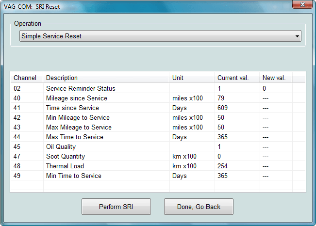

VCDS has an automatic system to give a simple reset much like VAS would normally be used but you can also manually adapt the Service Interval channels -

I don't think you can unless you have access to VCDS.

What 's vcds?
http://www.ross-tech.com/vag-com/
It's essentially a lead which when plugged into your Cali allows software on your laptop to 'talk' to the VW system built into the Van, it allows you to reset service lights, alter settings and scan your van for any issues.
It's another version of what the Dealers use when they service your van.
Ok, but why can't the vw garage change this setting? They tried (with their computer hooked up on my van) and eventually said it was not possible despite the service book providing the opposite information. Did Anyone had similare issue before?
VW diagnostic & programming software/interface. Can check for diagnostic problems, reset warning lights and re-programme certain ECU functions etc:
