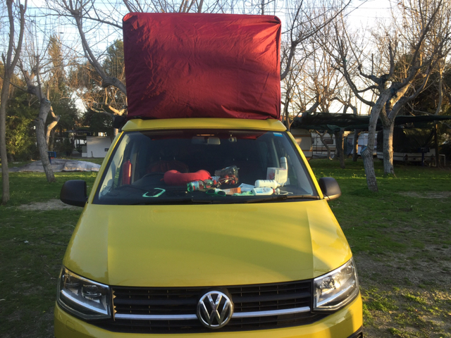

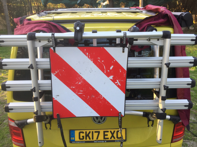

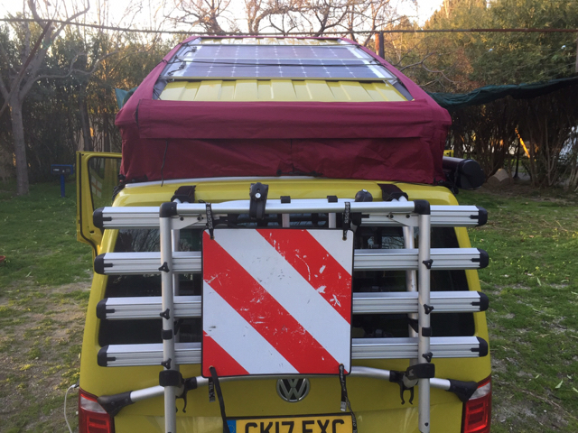

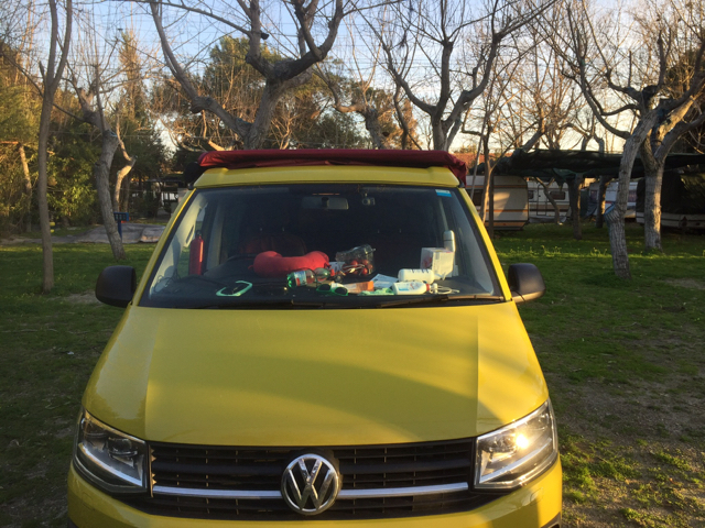

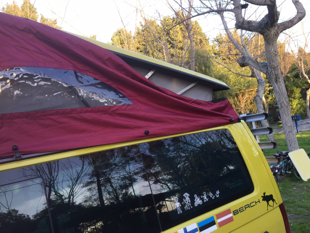

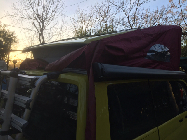

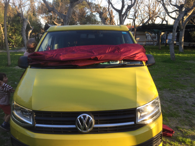

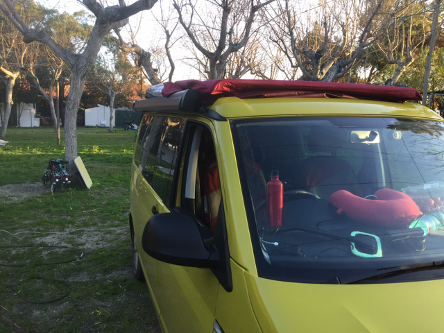

I did a little photo sequence for you.
Topper draped over wing mirrors
Top popped about two inches. Topper fitted to front
Sides roughly placed.
Rear mostly ignored, just draped.
Top raised.
Sides a bit messy at rear.
Rear not fixed
Rear fixed by standing on tow bar (or bumper)
First photo 16:18, final photo 16:31. Can be done in 5 to 10 minutes. It is my first job after unloading bikes. Topper is stowed with chairs.
