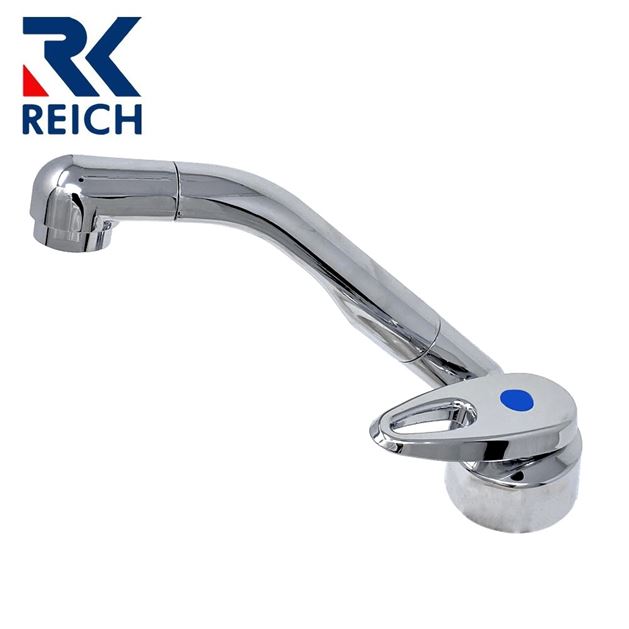

Finally I got the kitchen drawer out, I just wasn't being brutal enough!
I've found why it's leaking. The plastic shrouds that the tap Tails push into have snapped off. No idea how. I always drain the system down over winter and leave the valves and taps open.
I now need a replacement tap. I know it's a Reich tap but does anyone know the model name? I'm struggling to Google match it.
Photos attached
Frost damage.
Possibly but I always drain the vehicle properly over the winter. It's kept inside with the taps open. The heater run up at least once a month. Not sure what else I can practically do to prevent frost damage.
Thanks everyone. It seems to be a hybrid of the Samba body and the Twist spout. Looks like it's unique to the Grand. I ordered one from VW in the end as it was proving very difficult to find the correct match elsewhere.
