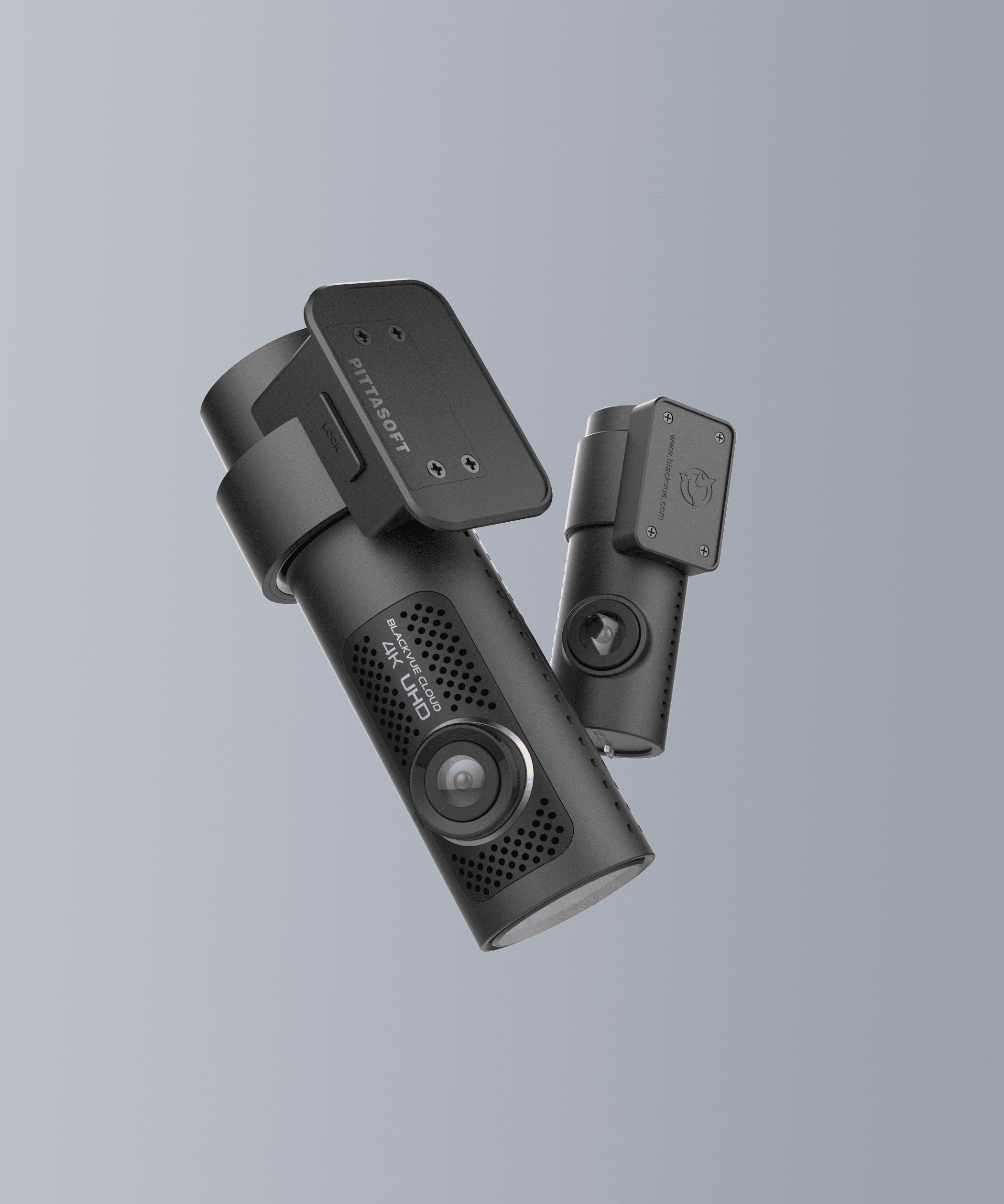

I have the Blackvue DR900X with the LTE unit. Works brilliant and gives me pan Euro wifi in the van for 4 quid a month. Took some fitting, especially the rear camera, but after some noodling it's well hidden and the wires nicely tucked away.

Into the fuse box for the blackvue. One perm live and one switched. The unit switches off (for me) when the starter battery gets to 12.5V (a figure I set in software ). In the newer 6.1 all the 12V are now wired to the leisures (I thought the cab one was starter but have checked and nope, leisures) so if you are plugging into a 12V you should either unplug when parked or set the software if it is in the system. On EHU you would be fine as the EHU will charge the batteries fast than the DashCam drains it.

Hardwired DRX750 2CH LTE Blackvue cameras front and rear with parking mode. Low voltage cutoff.
Excellent system and like you, no problem over the 3 years fitted. Has Live View function via the App on my phone (although never use it) and recently discovered it works really well as a WiFi hotspot.
* Rear camera fitted on tailgate glass so still functional when the rear blind is in place.

When you hard wired this in, did it need any additional kit over what’s in the box? I’ve seen there’s a separate Blackvue Power Magic Pro for hardwiring but not sure if it’s needed.

Yes, mine has the Power Magic Pro, however I believe newer versions of Blackvue cameras have that feature built into the camera? The installer I used (SatNav Solutions) also needed an extension cable for the rear camera.

Our BV 900 has the BMP built in so was not needed. You need a 10M cable for the rear, the 6M was not long enough but then I brought mine across the back, through the rubber grommet and cable hose, into the back door and across the top of the back door. If you were to just come out at the airplane lockers 6m would work, but wasn't a neat enough job for me.

The hotspot sounds very useful. I see from the Blackvue website that the sim card has 40GB per month. Do you know how much data you can use for other things whilst still ensuring that there is enough for the dashcam to operate properly?

We have the CM100LTE unit, which is the same really but seperate. Same SIM. In use it is mainly used to connect to the camera and exchange data if remotely looking at videos. We have not set ours to auto upload any which would use data. That means we have the full 40GB to use a month on streaming etc. The rub is you have no idea how much you have used because that is how the V Sim from Vodafone works. The only way you know it's ran out is if it stops working and you get a mail from them. Not even the app tells you. That said, only happened to us once. I asked them about this and they basically said they sized it for people to not have to worry. So I don't.

I don’t suppose you remember which fuses it taps into and where? Assuming the drivers side fuse box is the easiest rather than running it through into the engine compartment?
Edited to add another question: what’s the max SD card size that’s known to work?

I do - PM me and I'll send you a picture. Yes - come across the drivers headlining, down the A pillar post and into the fusebox. You will need to remove the A trim.
I have a 128GB one in now - removed the 32 it came with. Not all SD cards work, the Samsung Endurance Pro is the recommended.
