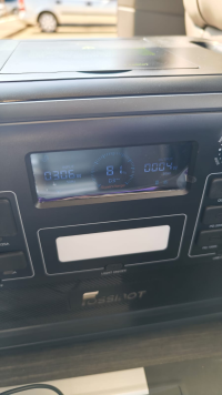

I have an appointment next month to update. I'm having the same problem with the battery. I've temporarily solved everything with solar panels xd1755512733211.png

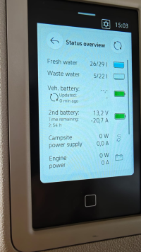

This weekend I purchased a EHU and connected it up on Saturday evening for the first time. After connecting up the cable I could see the display showing both batteries appeared to be charging and there was stated current draw from the EHU.
I've just been out to check something on the Cali and now the leisure battery is showing empty and 5v and when I tried disconnecting and then reconnecting the EHU I get an error saying no campsite power and an orange symbol on the display.
