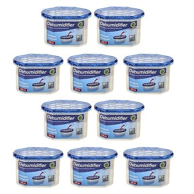

With regards to the condensation. Obviously the interior is damp.
1. Run the AirCon. It dries the air coming into the vehicle.
2. Whilst you have this problem switch the AirCon to recirculation to dry the air within the vehicle for at least part of your journey.
3. Consider putting some Disposable Dehumidifiers in the vehicle to dry out.
