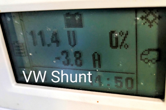

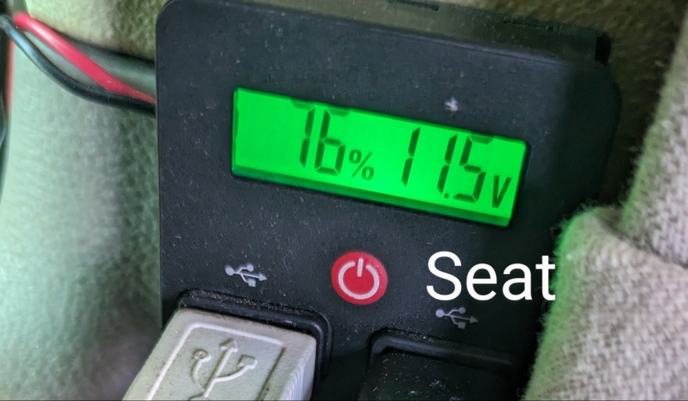

It's more or less the initial issue, thx for asking:
Both batteries are brand new and identical. And I changed the previous ones due to this.
I've noticed that the front seat battery tends to discharge more quickly and doesn't charge properly, while the rear battery remains more charged and operates without any issues.

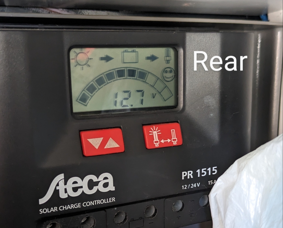

I have three simultaneous voltage meters: one is connected to the shunt (original vw meter), which I believe is roughly halfway through the circuit. Another one is directly connected to the seat battery and reads the same voltage as the shunt. The third meter is provided by the solar converter connected to the rear battery terminals (the solar panel is disconnected). I've verified the values at the battery terminals (multimeter) and they match the readings on the meters.

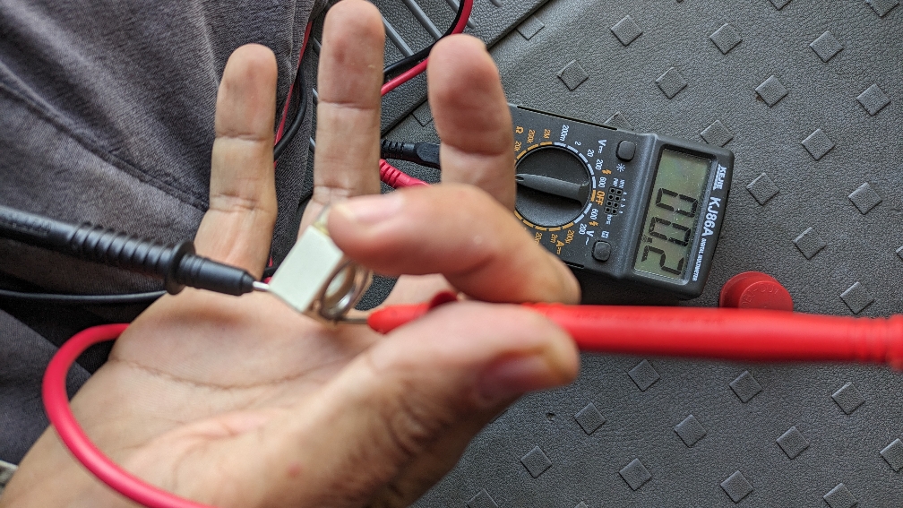

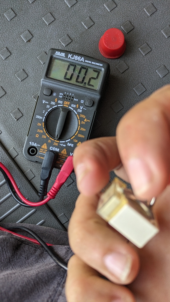

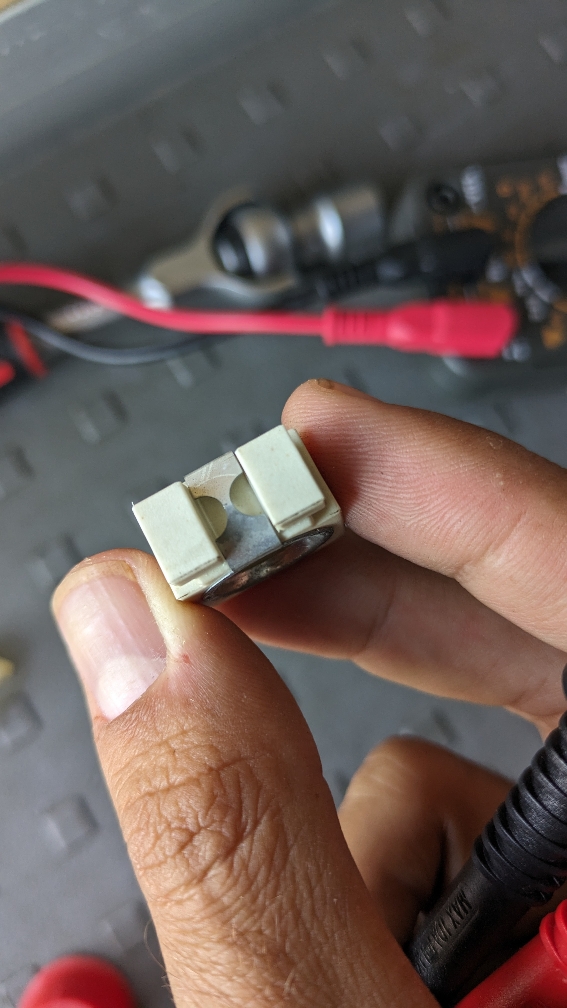

Right now, I'm making my second pit stop with the goal of ensuring whether the cube fuse is still intact or not (I had checked it before).
Resistance 00.2
That was the easiest route. Thank you, everyone, for your time and patience. It appears I'll have to search for the issue elsewhere.

I would now move onto checking the Earth ( -tve ) connection for the rear battery, as going by your Volt readings the rear battery is not connected in parallel.
If you remove the +tve lead from the rear battery, what voltage do you measure between the detached lead and Earth ( use the battery clamp bolt ) and the detached lead and -tve pole of the rear battery?
