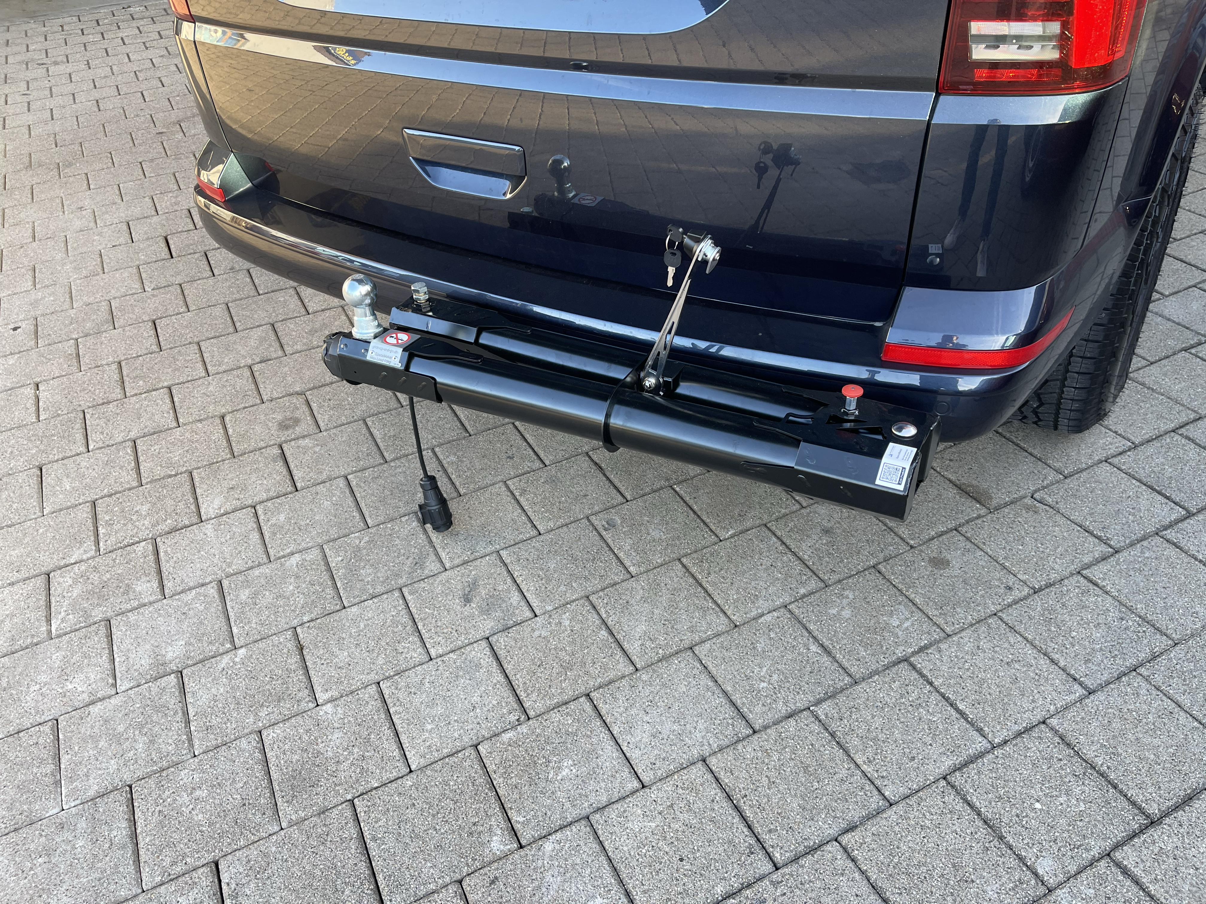

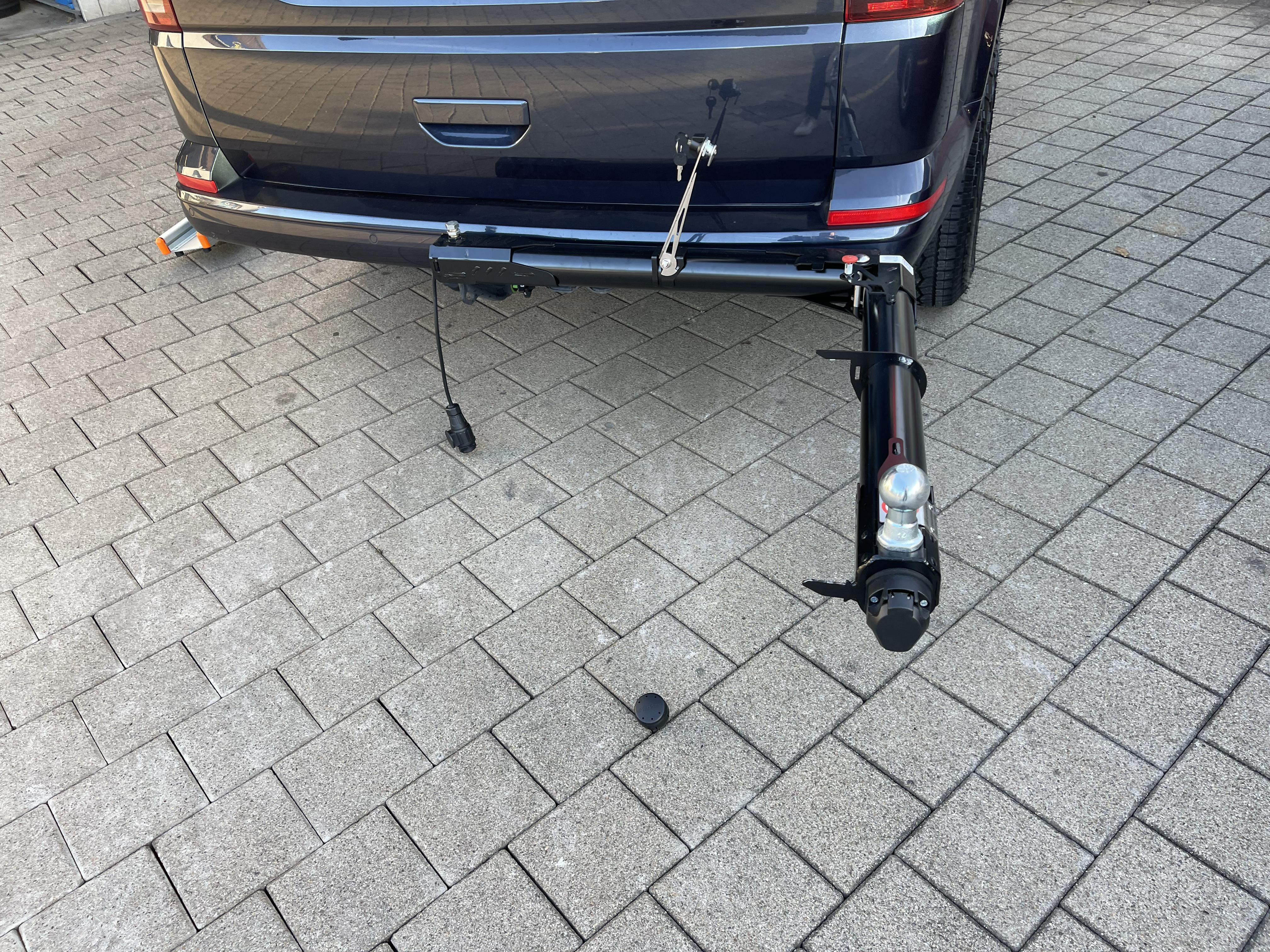

Here’s the one I use:
Thank you for posting.
What is the connection type/style for both to the vehicle and to the rack ?
Here in the UK we have this style of tow ball
It’s exactly for this. Mine attaches to my towball and then when closed the SpaceMaker towball is about 9cm farther out. It’s also slightly higher due to the design but not an issue for me. Can support loads of up to 65-70Kg.

Photos of when I mounted it
I might just road trip over and collect :)

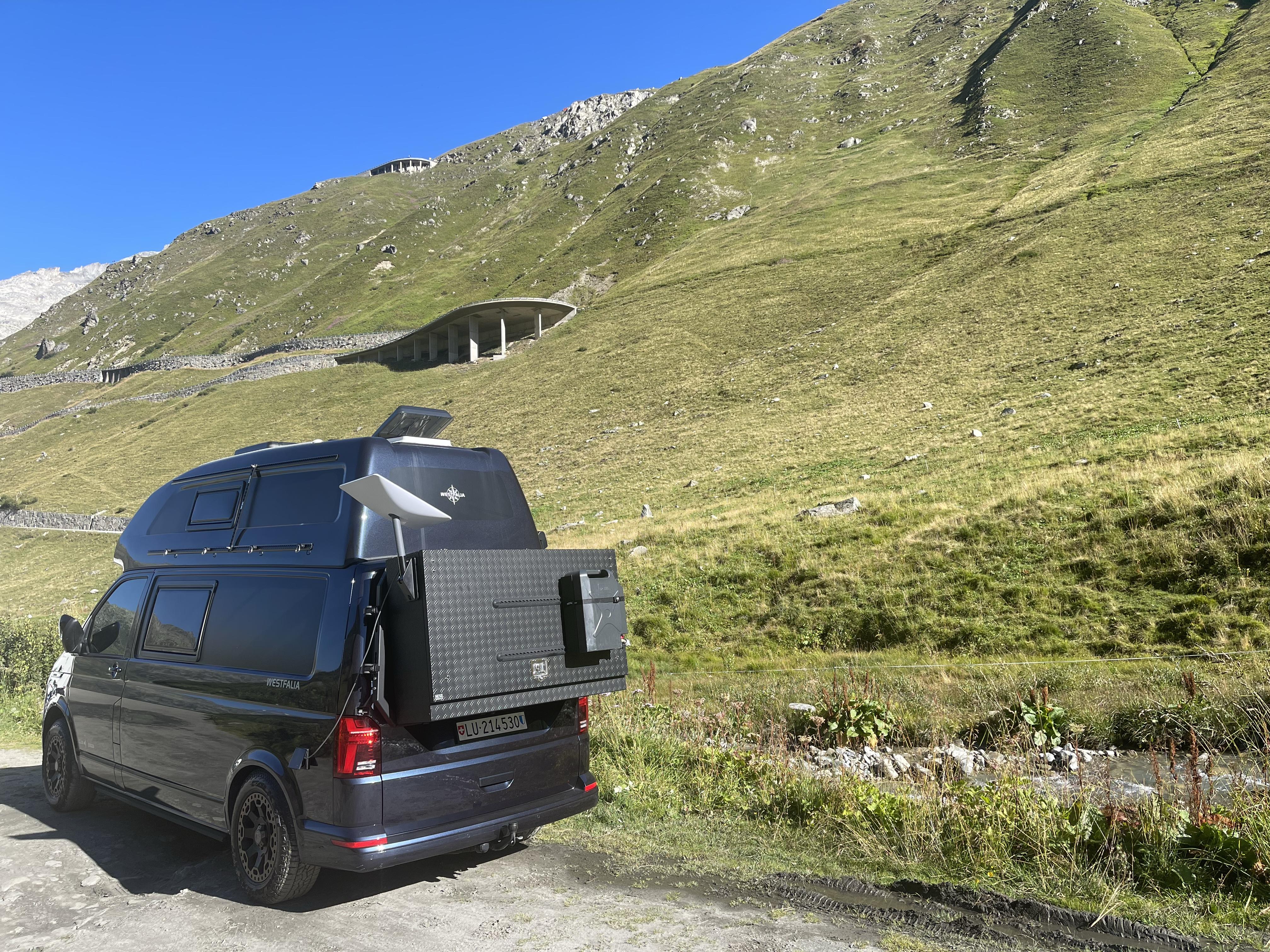

I was mainly looking for something to extend my towball outward so the handle bars would clear the storage box I have on the back. And then found this which was a bonus to swing away. Love it for mounting my bike rack or another storage box!
So versatile, ideal for cleaning the bikes in situ away from the van.
I even thought about some kind of outdoor kitchen/box for cooking outside..
