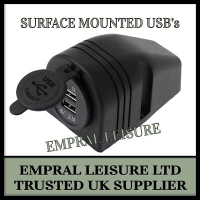

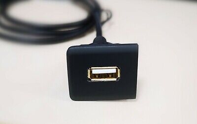

T.5.1 - We added USB for direct connection to a new head unit, you can get the usb dash plugs on ebay (just message the seller and they will be able to supply with bare wire to USB - instead of - USB to USB), then piggy back off your existing 12v dash wiring; See below link, they also do a double:
Its also easy to add a hidden one in the glovebox if required. There is a plastic blank in the top right corner of the glovebox that is easy to prise out, drill a small hole in the blank to route the cable, and then replace, or, screw a surface mount onto the inside of the glovebox. Glovebox keeps your phones out of sight if you should forget to remove them when parked up:
