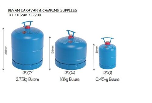

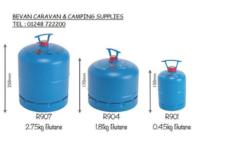

We have the LP version. If you have an Ocean the LP makes even more sense as you can carry a 901, 904 or 907 cylinder as a spare and use it for the Cadac.
Similarly, if the spare runs out, you could use your main bottle for the Cadac.
Hmmm, maybe I'll try the 901 or 904 next, once my current cartridges run out.
2 x 907's is overkill for me and space in the boot is at a premium, but I like the idea of the smaller bottles.
I would guesstimate that a 901 bottle would last a couple a week's worth of hot meals and hot drinks. In most circumstances, plenty for a reserve supply.
