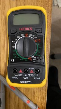

Ok, got my kit for testing. As I’m clueless with this sort of thing, could you advise the setting and what to stick where (so to speak).

Put the black lead in the COM socket and the red lead in the VohmmA socket then turn the dial to the red buzzer symbol. If you touch the ends of the leads together you should hear it buzz confirming continuity.
Go the the rear battery and place one lead on the bottom of the cube fuse on the + terminal and place the other lead on the top of the cube fuse, the multimeter should buzz if the fuse is OK, if not you need to replace it. Think you can buy it from the Cali Shop.
Let us all know how it goes.
You can buy the 50A or 75A Cube fuse from here or VW (check the current Amp rating on your blown cube fuse could be 50A or 75A).

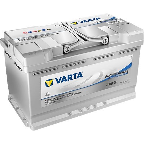

If you are a member of the Caravan and Motorhome Club you get 10% discount at Tanya Batteries (Varta LA80 for leisure batteries)...
UPDATED: may have ended in Dec 2020 so check first.
UPDATED2: Just emailed Tanya and 10% offer still valid with code. :)

Done the test. Got the buzz, so fuse would appear to be OK. I’m guessing that’s bad news for my wallet.... unless there is anything else to check prior to replacing batteries?

Worth trying to charge each battery separately then load test them with a headlight bulb or similar across the terminals to see how quickly the voltage drops. If either battery is no good replace them both with a pair of the Varta LA80 or similar from Tanya etc. Expensive but if looked after they should last 10 years, my 2010 Cali is still on the original leisure batteries and gives me 3 days off grid.
Can I ask the basis for replacing as a pair if one is still decent?
If both batteries are of the same age and one is dead or dying the other will follow soon. If a poor condition battery is paired with a new battery it could impair the life of the new battery so it's good practise to replace both batteries especially as battery technology has changed significantly over the years.
