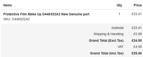

*Added:
The tape appears as ‘protective film’ under reference 35. Her are some links:
https://www.lllparts.co.uk/catalogs/vw/RDW/CAMP/1058/8/875/875010
