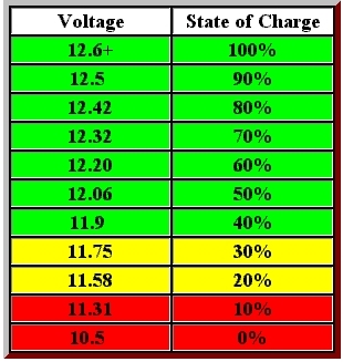

The above may vary with different types of batteries but is roughly in the ballpark.
