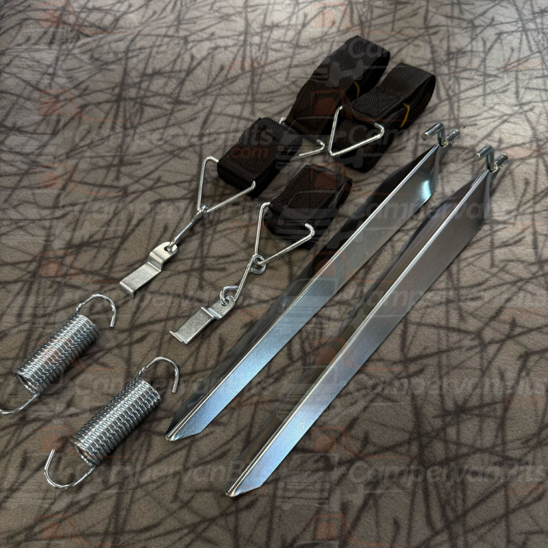

You need a Tie Down Kit. Guy ropes/straps they go from top of leg to ground peg. Tighten and then wind in awning to tension material. DO NOT over extend the awning so that the folding beams are straight , they should always have a slight fold inwards to aid winding in otherwise they can jam and not fold.
