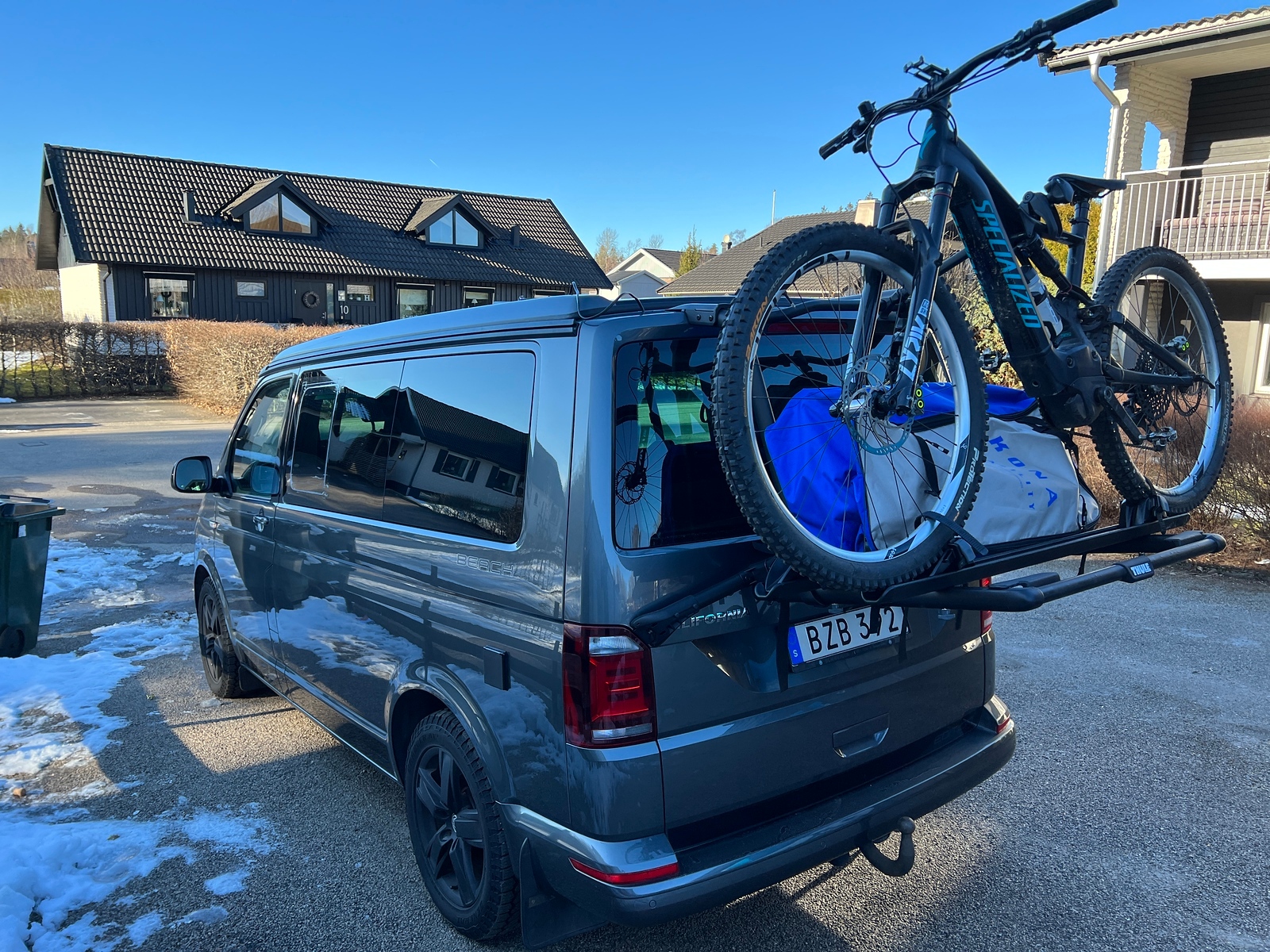

We have two solar panels on the roof already and in winter the original struts have a hard time keeping the fabric stretched.
Both the original struts and the replacements are longer than they can be when roof is up so they need to be compressed to be able to mount them. I tried with bands and clamps which worked out ok.
Now the roof easily stays up with both roof panels up and I am sure I can have a roof rack and an inflatable sup there as well.
