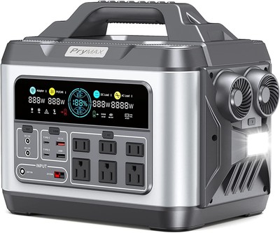

Even if you were able to fit an inverter that was able to do that it would drain the leisures so fast as to make them dead as door nails before you had got through making your second coffee. Just use an Aeropress like the rest of us coffee lovers. There is a pretty sound reason why the inverter tops out at 300W for the newer Calis. If you're that desperate take a power station but then most of those also top out at 1000W. So....

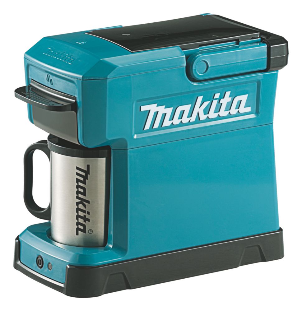

I use one of these on site - uses 60mm pods or whatever coffee you want to put in the holder.
You get about 3 cups out of a 18v 5AH battery pack & it takes about 4 minutes per cup.
I have loads of those battery packs laying around as they are used in all my Makita gear. I have the makita 12v - 18v charger, it's slow but will do in an emergency.
The 240v charger does 2 of the 5AH batteries in half an hour.
Theres a decent tyre pump & torches etc that also use the same battery.
If you've already got the batteries & charger it's worth buying the coffee machine. If you havn't it works out pretty expensive.

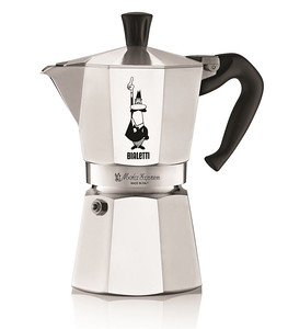

So this will do it ( it is on my Chris-mass gift list):
BIALETTI
It's a solution that I find acceptable. If these things matter to you bialetti also do a stainless steel version ( search Venus)
