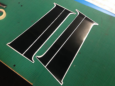

I'm looking at getting some gloss black decals to cover the B pillar, a la:
The advice on the listings is to get someone professional to fit them, although some people get on fine with it. Can anyone enlighten me as to how these are actually fitted? Hopefully that should help me decide whether I want to give it a go myself. If I don't, who would be an appropriate professional to get these fitted? A bodyshop? A detailer? I can see fitting costing more than the decals... Thanks!

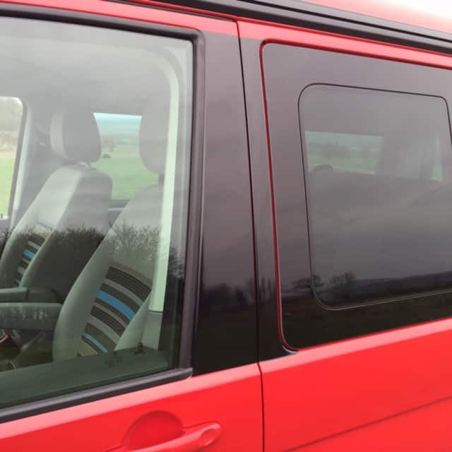

Well we actually had some sunshine today. I was beginning to think we'd seen the last of it. Anyway, as it was warmish enough, I decided to have another go at fitting the second set of black shiny B post decals. The last ones had very strange random patterns all over them. Today's fitting presented no issues and here's the result. I also fitted some Dubflectas as well.
Whilst the finished result is miles better that last time, I'm still not that bowled over by the surface finnish. The above photo shows the O/S B post with decal fitted. It still has a mottled appearance and there were several lines across the finnish. You can just see one where I have indicated. This time I warmed the bodywork with Mrs B's hairdryer and warmed the vinyl as I peeled the protective paper away. I also peeled the protective paper off in one go without stopping so that didn't cause the marks. Is this sort of finnish normal?
I've left these latest decals in place even though I'm not that happy with them. I can always remove them later.

Van looks great Borris, I was thinking of adding these to my van but not sure now, without being rude have the decals left a slight orange peel effect on the surface a bit like a poor respray and can anyone confirm if that is normal.

You are not being rude. Orange peel effect is an excellent description. There are also other lines and marks as previously stated. I am 99% certain that these flaws are nothing to do with how I applied the decals. I don't know if I'm being over fussy but if this is the kind of effect one can expect, then vinyl wrapping isn't for me. The only thing I can add is that it doesn't damage the vehicle and can easily be removed. I will put up with it for now.

It’s disappointing for you that you are not 100% satisfied after all your efforts Boris. We are very happy with ours, no orange peel / marks, possibly there is a difference in the quality sold by different outlets or maybe we’ve been lucky as ours were professionally fitted?

Did you use any heat, the finish looks great.
I pre-warmed the bodywork with a hairdryer until it was no longer cold. I also applied a little heat to the vinyl as I removed the protective outer covering.
I used a hair dryer to slightly warm the panel and also the decal. Use a felt edge applicator to apply and kept heating the decal as this helps with the adhesion. When you come to wrap the edges around the door edge and also finish off behind the glass the heat allows the decal to mould to the curves etc.
I’d really like some of these and on the cusp of buying some. I’ve read about putting one edge under the door window seal, could someone please explain how much of the decal folds around the door edge or other exposed areas? If any. And if anyone has visited a pro, how much were they to fit? TIA
The Club Shop ones have a tapered edge to the upper and lower edges which indicate the point which will align to the door edge and makes a neat finish. If you have then in front of you and offer then up to the panel you will see how they work.
