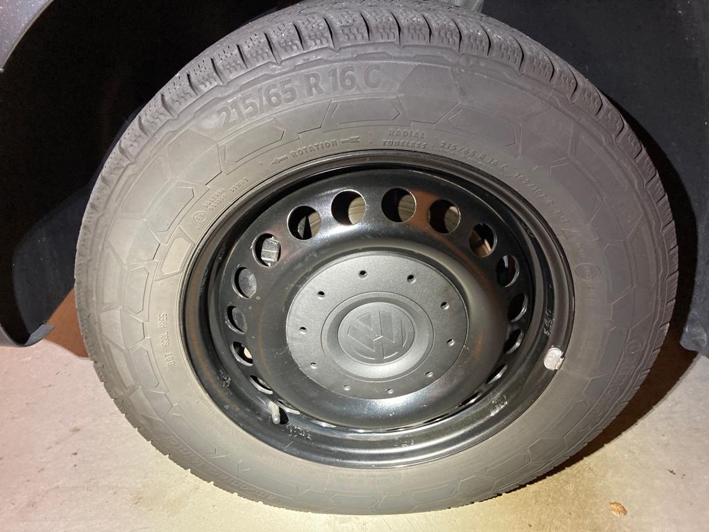

We have always run 215's on our Beach (not winter tyres). Ride is fine for us and find it gives us more tyre choices & they tend to be cheaper to replace. Less chance of sidewall damage due to narrower width.
But can understand why many fit 235's for cosmetic reasons.

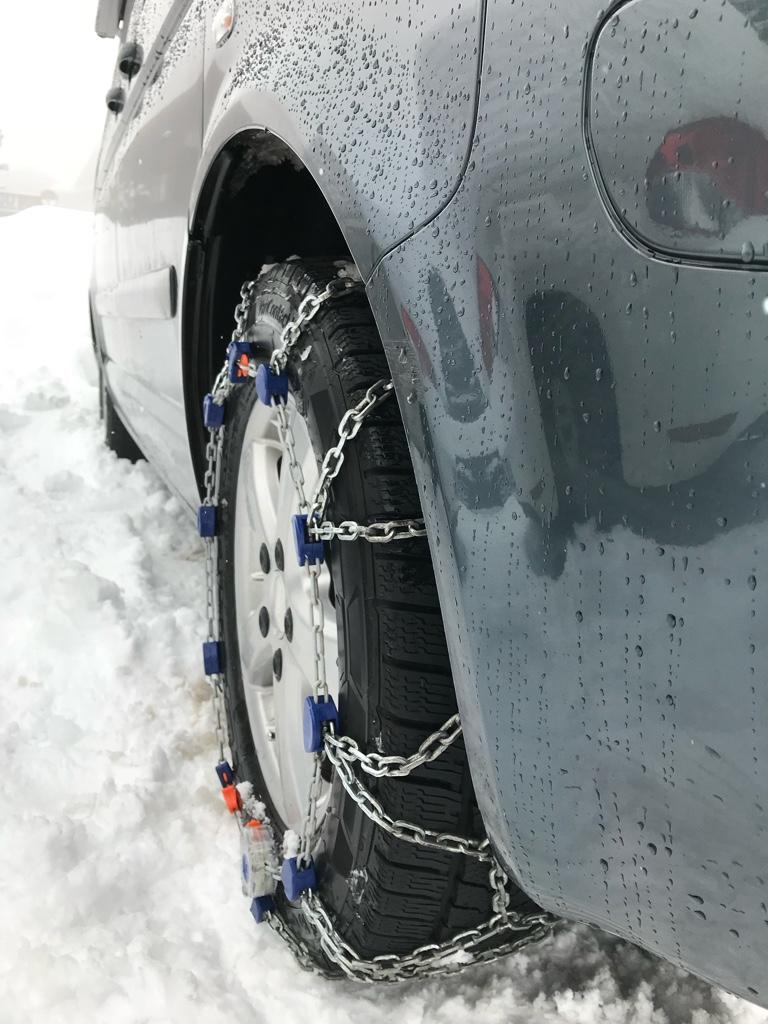

We drive some ContiWinterContact 215 ones because we sometimes need to wear chains and keep them til May.
