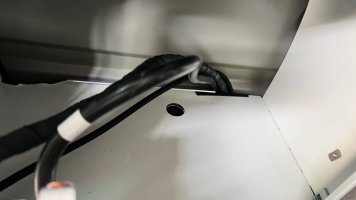

Yes the original shunt comes from the negative pole of the rear leisure battery, see photo.
You should be able to put the new additional Bluetooth shunt in series with the original shunt without affecting their accuracy BUT please check with the Bluetooth shunt manufacturer first! Make sure good quality cables and connections are used to reduce resistance.
Hi many thanks, for your reply and the photograph, the manufacturer has confirmed to another user it would be fine, however i will ask the question myself
and I understand re using a suitable cable to complete the attachment
thank you again
