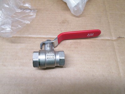

Not sure what the retail price is for the part but if its more that 25 quid this would be an option

Thanks Corrodobit, think this image is of the freshwater valve in the cupboard accessed from the tailgate.I have an issue with the waste water valve. Thanks all the same for advice. T
Same part number as per WG's exploded parts diagram.

Looks identical to me and after all, it is only a standard tap.
Wesel
Wesel
594
Belgium
T6 Coast 150 4Motion
This valve strongly resembles a standard plumbing valve. In my opinion it is not a specific VW part. For under €6 you can find one in stainless steel. Search "ball valve DN15".
