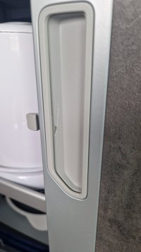

Currently away and the left hand cupboard latch appears to have cracked..
Where can I get a replacement? Is this a warranty item, they don't seem particularly robust.

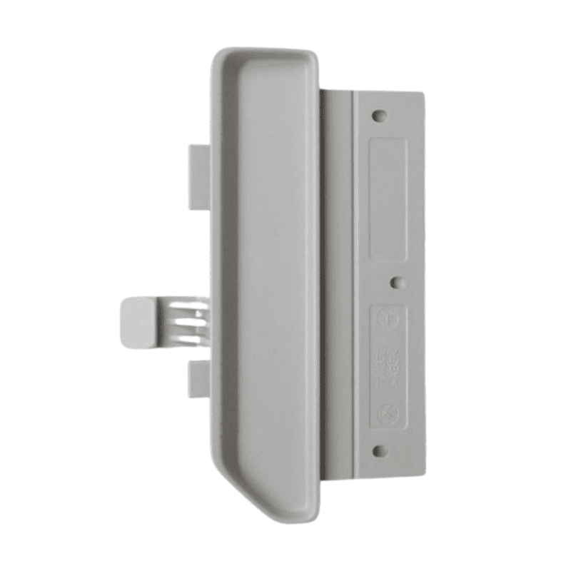

Judging from the German forum this happens a lot. You can buy it at VW or the club shop or Campervantastic. 17 pounds. Partnr is 704359.

If someone has a broken latch on the LH kitchen door (which is a common problem), they might do two things: buy a new handle for around ÂŁ20 and, when fixing it, add the reinforcing bracket as per my linked post above. Alternatively they can go to the ordeal of dealing with VW either under warranty or not.

The LH kitchen door has a latch in the door, that easily breaks but can be replaced for about ÂŁ20 and a keep that is in the frame which is more complicated to replace if broken.
My post related mainly to reinforcing the latch (which coincidentally acts as a stop for the RH door and therein lines the weakness) with a 3D brace so that it resists breakage. It also referred to improving the strength of the tongue that forms part of the keep.
What puzzled me is why you would want a "3D-print model for the latch" when you can buy the VW OEM for ÂŁ20, which though it breaks would still be stronger than a 3-print: the latter being almost inevitable weaker given its layered construction.
