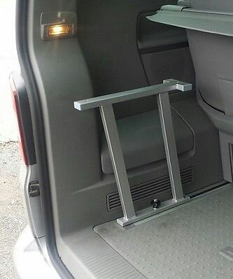

eBay sellers offer side uprights that I'm assuming would replace the frame. The existing board would then go back on top - higher and with no underneath support bar. But do these all fit and wouldn't the board sag?

All the aftermarket side upgrights ive seen are based on the 3 seater/caravelle height. As well as being higher their board hinges in the middle. Not sure if that board is reinforced along the hinge edge to prevent it sagging.

The two seat multiflex is a pain. It's too deep and takes up a lot of living space. I bought a pair of the multiflex legs from ebay, had them shortened by a local blacksmith and then added a custom top in 18mm ply.
The result is another 200mm or so living space and a lighter multiflex unit.

Hi mjrose. Im thinking of doing the same thing, did you just make the new board 200mm shorter? if so is the bed still long enough? I was thinking of possibly making a MFB the same as the 3 seater Beach but at a height to suit the 2 seater.

Hi Skippe, 200mm shorter where the bench is but the section next to the box is the original depth. The board is now an odd L shape. 200mm suited us but we don't use the downstairs bed much. When we do my toes stick over the end slightly. Good luck!
Hi mjrose, your conversion looks great, I am going to change mine and will try to make the front piece hinged. I saw some brackets on ebay and wondered which ones are best suited.I would not have any trouble lowering the height.your advice would greatly appreciated.
Hi Patnolan, I bought the legs with a t piece as the photo below shows. I was worried about the board resonating and the T adds stiffness and prevents 99% of vibrations. I'm afraid I can't find the legs on eBay anymore but they were from Germany. My board is unhinged so I can't help there but I agree, hinges would make a more useful board!
