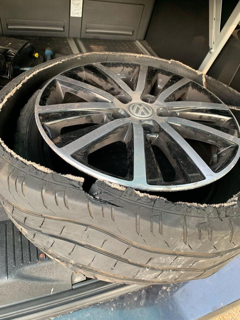

Hi all, just posting here on this topic. We suffered a blow out whilst travelling on a dodgy bit of fast dual carriageway way. Luckily no one injured. The van was travelling at 70 in the slow lane. But the tyre took out the ABS sensor wiring, damaged the rim. VW assist were called. AA turned up. My wife was there with kids. AA man managed to change tyre. I was relieved the spare safe came off ok (copper grease!). The wheel apparently needed a hammer to remove despite having been serviced (major) by VW Bury 6 days prior. The tyre was a continental van contact 200 with 7mm tread and inspected by VW 6 days prior. I was surprised by the extent of the failure. Doesn’t give me confidence in these tyres. Always used Michelin before. Used to drive lots of miles and Michelin primacy never let me down. I’ll be changing to cross climates as soon as practicable I think.

You should contact Continental as they will be interested in checking for possible faults.

I nevertheless wouldn't point at the specific brand and model of the tyre as culprit or lacking safety.
On the contrary these are probably the most common and hard tested tyres on a T6 as they come as standard equipment on T6 commercial transporter also. T6 is the most popular transporter in Germany and people drive them a lot and often also above 100mph.
It certainly isn't an issue of the brand/model, rather that specific tyre must have been damaged to fail so sudden and so badly.
You didn’t say if it was front or back wheel. Back wheel not so bad, Front wheel Brown cords time. Always thought as part of. Major service they took all the wheels off to check the brakes..If that had been done the wheel would have come straight off.
It could have been some debris on the road that hit the sidewall of the tyre.
Any other tyre would probably have suffered the same fate. I wouldn't avoid continentals because of it. Put it down to bad luck.

How old was the tyre? The production date is stamped on the sidewall.
It can be a delayed failure after the initial damage was done by hitting a pothole previously.
No shortage of those.
As said before not a Continental specific problem.

Hi all thanks for replies. It was front near side. Probably the hardest working tyre for RHD. As others have said prob just that tyre. It honestly looks almost new in the video VW sent me 6 days prior on their service inspection. I would have thought they should take the wheels off for a major service. You really do wonder what I paid £420 for! (Full service plus brake fluid). There was some evidence of a puncture wound. Pretty shocking though that kind of collapse. Good to know where your locking keys, bolts etc are because the AA man didn’t have the time or patience to look. He was quite grumpy said they get only 15minutes for a tyre change. Wasn’t interested in helping other than what he had to do.

I had the same level of destruction on my FNS, Goodyear vector all season, but thankfully not going very fast.
My heart sunk when I saw your photograph, thank heavens you all were unscathed. Sorry about your tyre, it's just a bit of rubber and steel though, you are not, you all are unique and irreplaceable. My thoughts are with you.
That blowout looks horrible, glad that nothing serious happened.
