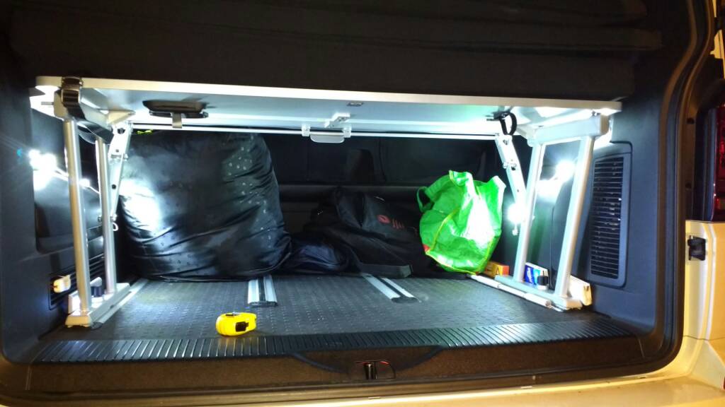

I am thinking about installing some led lights in the trunk.
Do other Beach owners have the same problem?

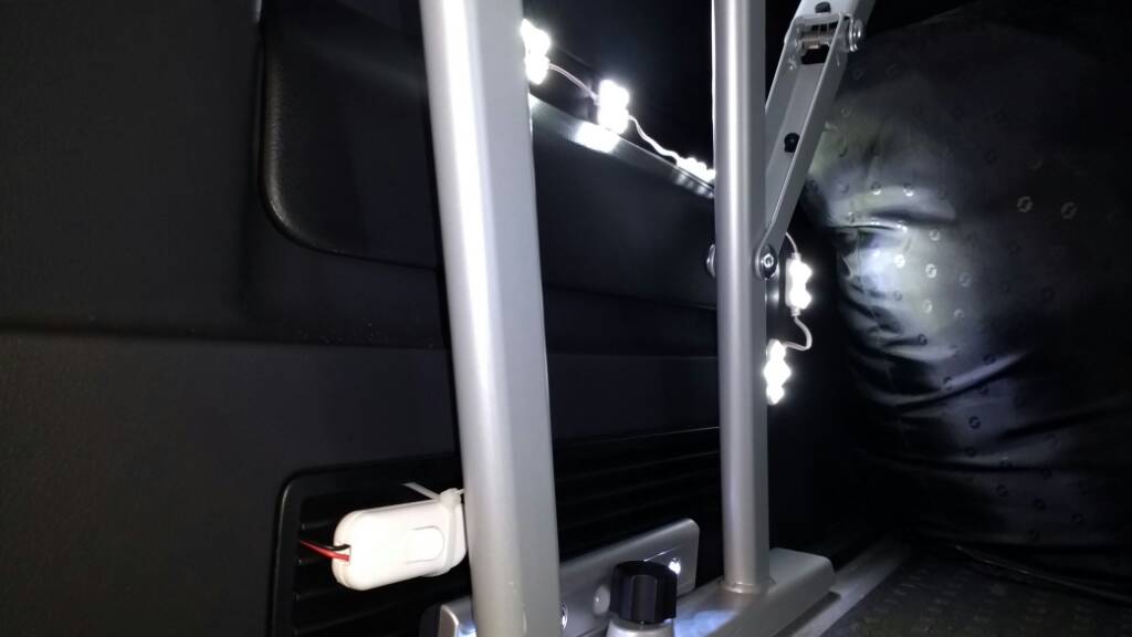

I tapped into the light on the rear pillar and ran a wire to a self adhesive led strip light which is on the side panel under the multiflex. Press Switch on the light now switches on both.

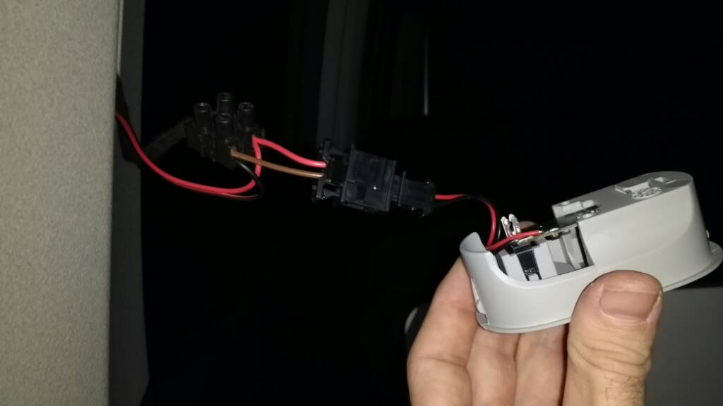

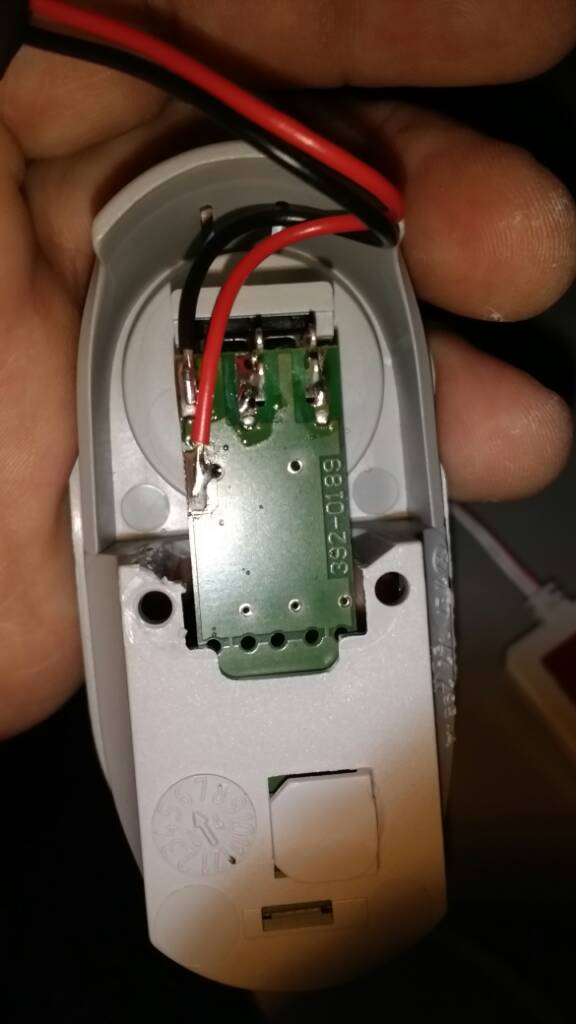

I've tried that but in my case it is a led lamp. To tap it after the switch I would have to weld the wires. See pic
So I tapped it before the switch and added a second switch
Like this you mean?

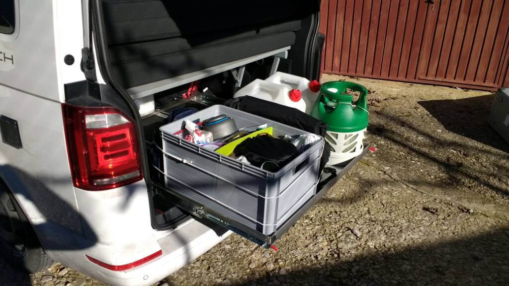

We made this sliding tray for the trunk and it makes it really comfortable to reach the stuff while cooking.
