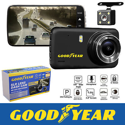

Had a hunt around to see if any possibility. Nothing found just how to add a reversing camera.
I did consider use of VCDS to make it active permanently but then possibly no other display function available.
3 possible options to consider/investigate.
Add a WiFi camera and link to it on the display?? or simply use a smartphone as display.
Add a second rear view camera and dedicated display.
Add a Front & Rear view camera system with the rear view displayed on the screen. bit small possibly
Something like this. Camera could be mounted inside on the drop down storage unit to simplify wiring.
Thanks, now found a system with a screen that replaces the interior rear view mirror with a rear wifi camera. Looks like it will do the trick. Not sure why some people have been so dismissive of my post. I note many new HGVs now have this type of system installed and it has also started to appear on some new cars. Anything that improves safety is good in my book.
