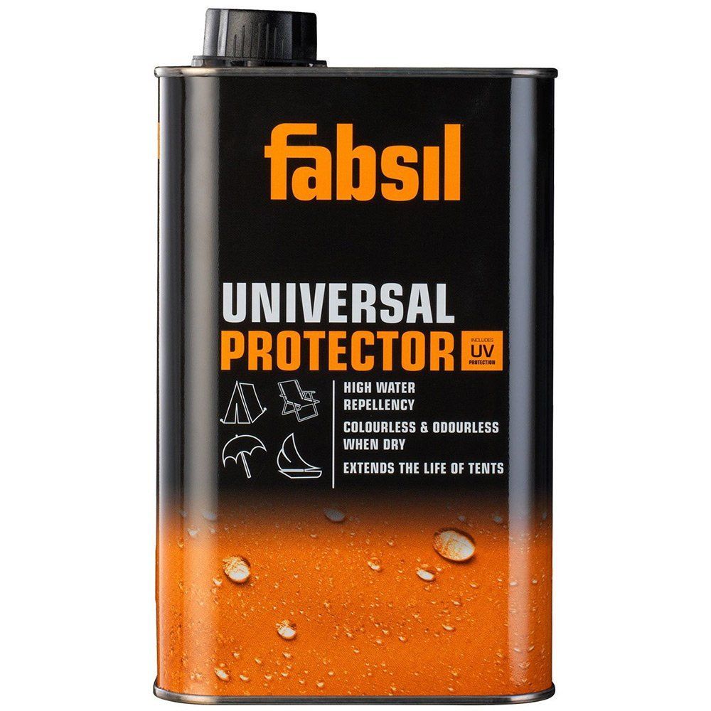

There is otherwhise a Product wich is used to Seal up om tents to make them again waterproof. Maybe this is something to look at. Should be sold in any decent outdoor center where they sell tents ofcourse. ;-)
