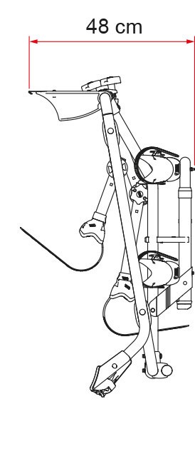

I have a Fiamma T6 bike rack, it could work for you, I will measure the back projections for you if interested.Bike rack.jpg
Yes please - would be very grateful
Complicated but here goes.
The double horizontal tubes lower surface are 66.2 cms up from bumper top surface.
The outer edge of these tubes is 13.7 cm measured in a horizontal distance from the hatch surface .
The most projecting parts are the rubber covered nuts holding the bike support rails 26.5 cm out at 97 cm from bumper top surface.

That brilliant - many thanks for taking the time to do that.
